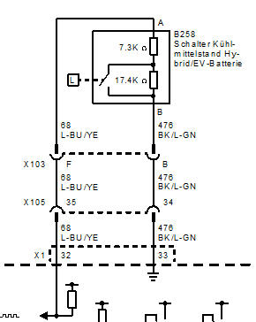

    Quote Originally Posted by ampera_jed View Post
    Out of curiosity (sorry if I've missed it and this has been asked and answered), how does the sensor work if there is no contact with anything. Is it capacitive?...
    Quote Originally Posted by somms View Post
    WOT explained in earlier posts that the sensor resistance output is based on how it detects the level of the float in the tank thru a magnet I believe...
    I am probably wrong but my recollection is that it emulates the proper behavior of the actual sensor when the fluid level is correct and does not actually measure the fluid level, and that is why WOT has reminded us all to regularly check the fluid level after installing the 'sensor'.

    Quote Originally Posted by kns View Post
    I am probably wrong but my recollection is that it emulates the proper behavior of the actual sensor when the fluid level is correct and does not actually measure the fluid level, and that is why WOT has reminded us all to regularly check the fluid level after installing the 'sensor'. KNS
    I think ampera_jed was asking how does the original sensor work if it is not actually inside the tank? Which I would also like to know.

    Sorry, yes I mean the original sensor.
    I expect the replacement is 'just' a passive resistor.
    I can't see how a magnetic sensor in the original would detect an aqueous solution.

    Quote Originally Posted by TSquare View Post
    It's a reed switch that closes when in proximity to a magnet mounted on the bottom of the float in the reservoir. The switch state changes the electrical resistance in a small resistor network and the resulting voltage drop monitored by the control module.
    The orientation of the replacement sensor doesn't really matter as it is an environmentally sealed connection as is the device itself.

    OK, though I can't say I spotted anything floating in the reservoir!
    There are, still, wires going into the back of the connector, never perfectly sealed grommits. I was thinking just to cable tie the WOT thing onto the sensor and just thread the sensor back into place. That will keep the same appearance from a casual glance and the service techs will be less likely to throw a fit over something they don't understand.

    If you look down the reservoir with the cap removed , you see a dark square device on the bottom of the reservoir,,,looks like small magnet , no cables.
